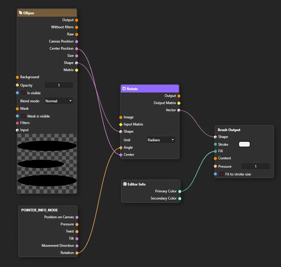

Let’s start with simple stuff, a basic vector brush.
and the graph:
Nothing fancy, just a vector layer plugged into a brush shape with rotation applied.

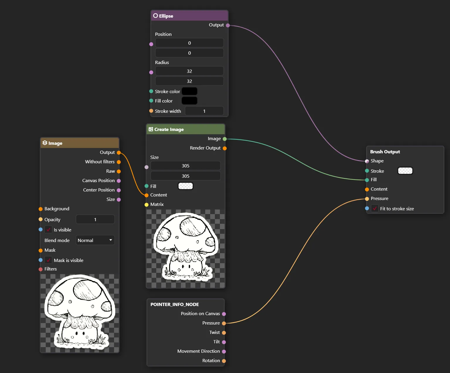

Raster, pressure-based brush.
Obligatory texture brush
Graph:
Pressure-based, scaled image as a brush.

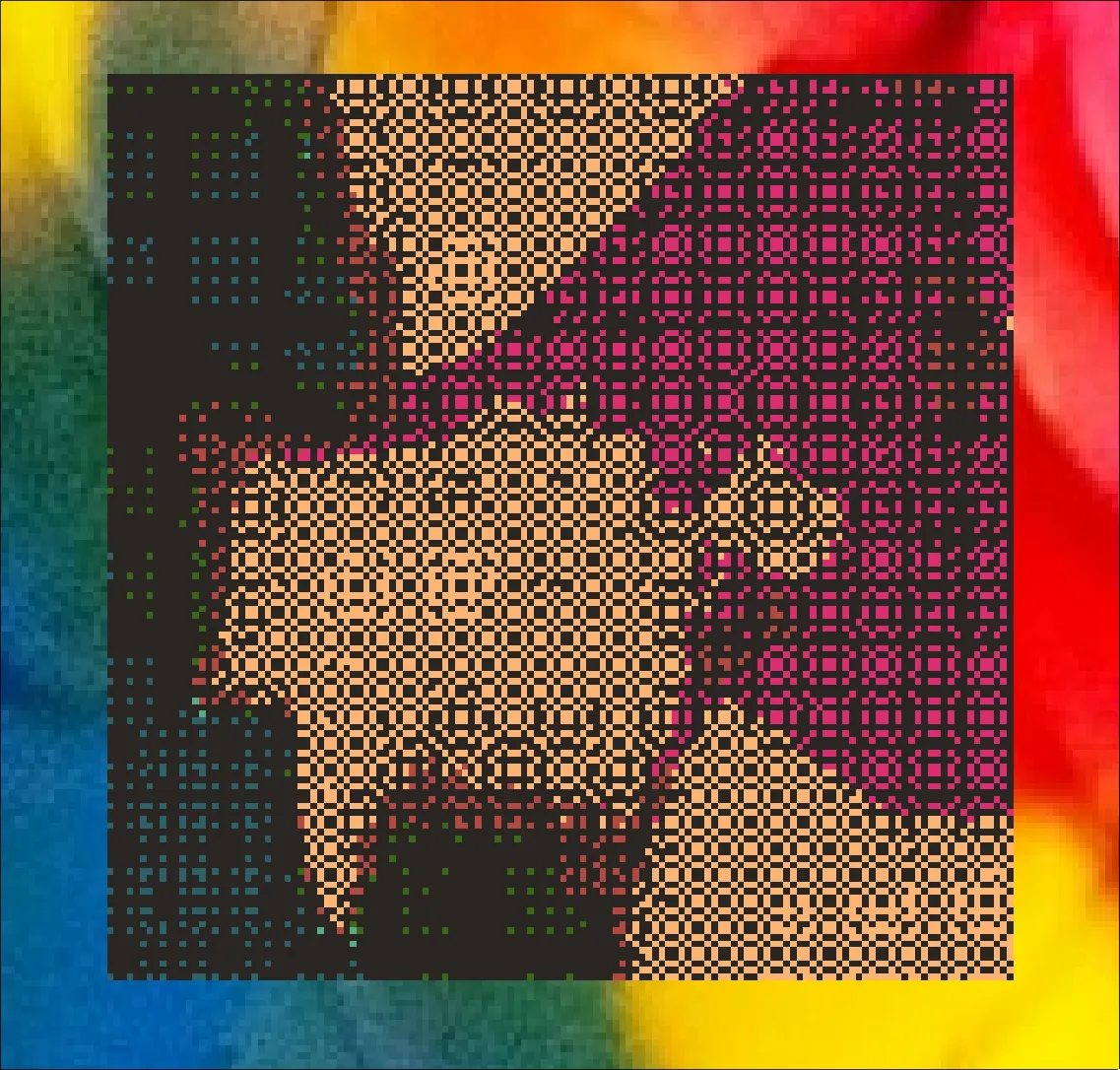

Procedural dithering + palette indexing brush
Time to step up the game.
Here is an example of a brush that automatically dithers and applies color-indexing to the image on which it is drawn.
Let’s take a closer look at the effect of this brush:

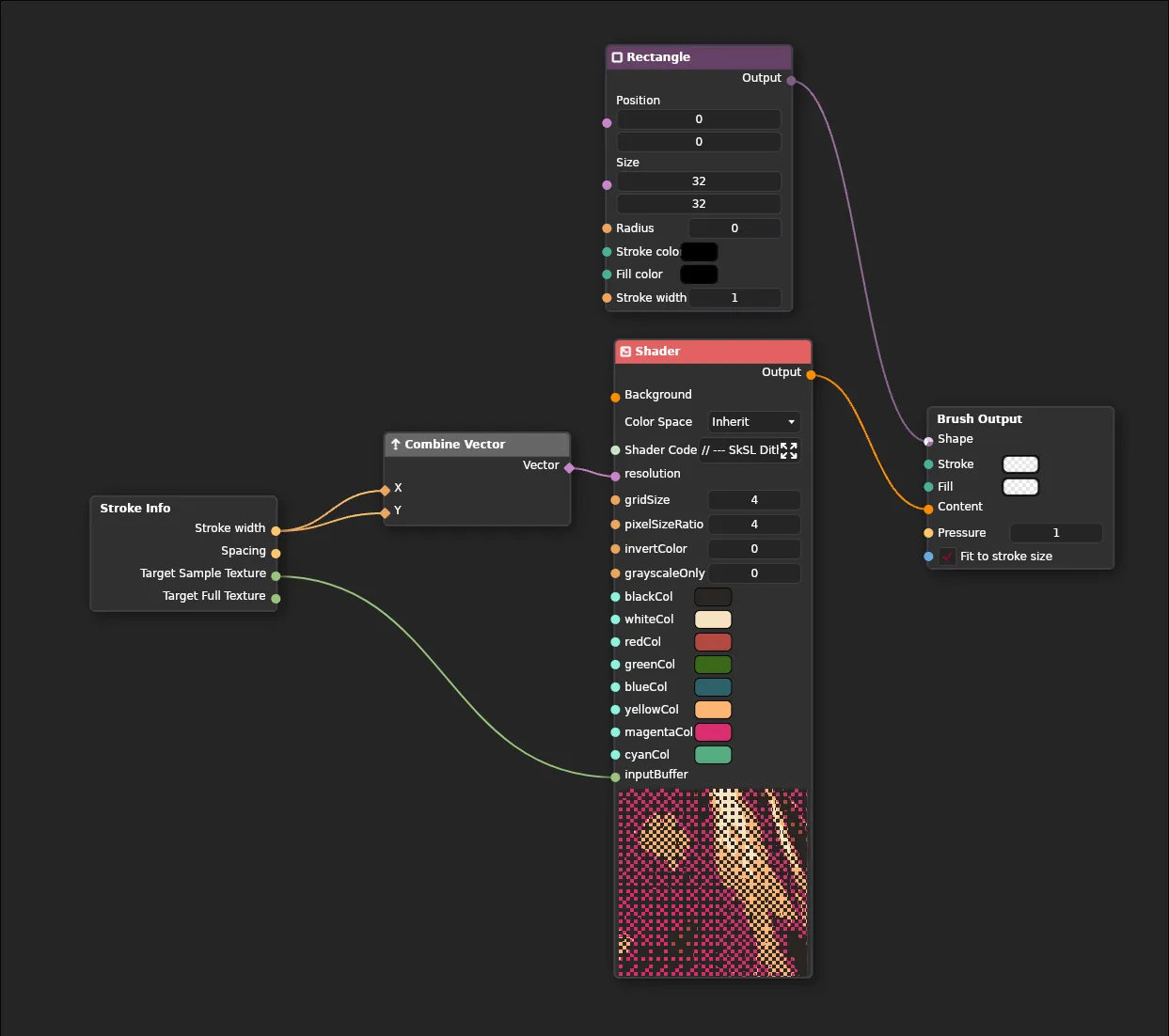

And now, a node graph of this brush:
As you can see, we can plug anything into the Brush Output, the same way as it works with other Node Graph-related stuff. I used a Shader for this one based on this blog post.
Naturally, anything that Brush Output exposes can be procedurally generated, such as the shape or fill of the Brush.
